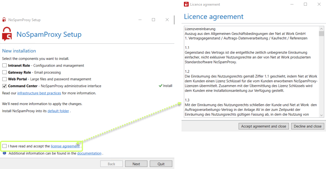

Starting the installation
  1. Click the setup file of NoSpamProxy. The wizard guides you through the installation.
  2. Read and accept the licence agreement.
NOTE: Further information on the licence agreement, the terms of use and the order processing contract can be found on the NoSpamProxy website.
