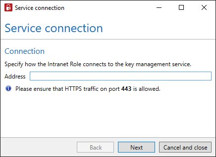

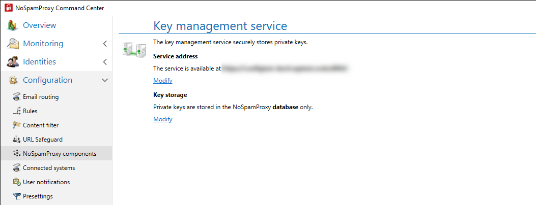

- In the NoSpamProxy Command Centre, go to NoSpamProxy components > Key management service and click Modify.
- Enter the service address under Connection.
NOTE: The default address is https://localhost:6064. In any case, make sure that HTTPS traffic is permitted on port 6064.

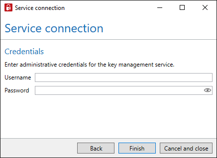

- Under Credentials, enter the administrative user information for the service.
- Click Finish.

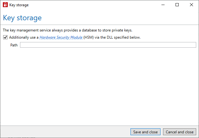

- In the NoSpamProxy Command Centre, go to Configuration > NoSpamProxy components > Key management service.
- Under Key storage, click Modify.
- Tick the Additionally use a Hardware Security Module (HSM) [...] box.
- Enter the path to the HSM DLL file.
- Click Save and close.

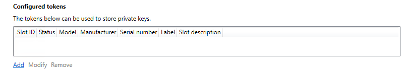

The Configured tokens area now appears under Key management service.

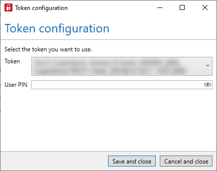

- Under Configured tokens, click Modify.
- Under Token, select the desired token from the drop-down menu.
- Enter the corresponding PIN under User PIN.
The HSM is now connected.
