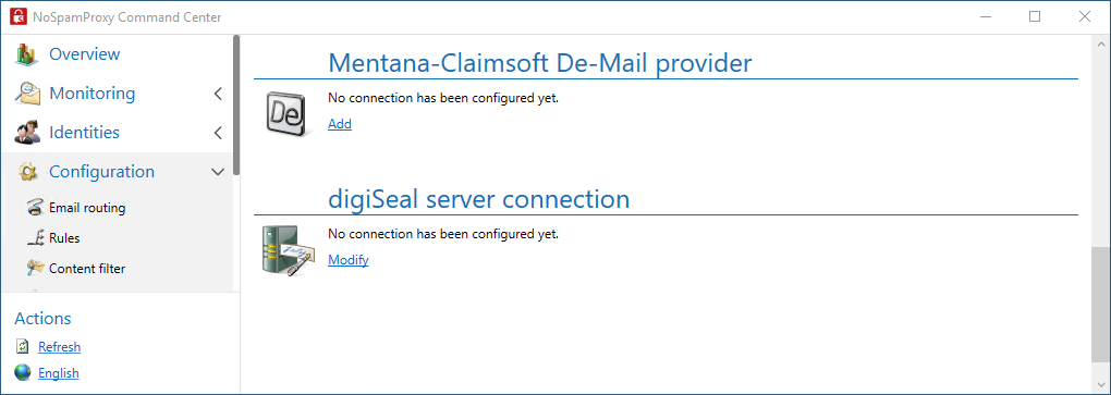

- Go to Configuration > Connected systems > Mentana-Claimsoft De-Mail provider.
- Click Add.

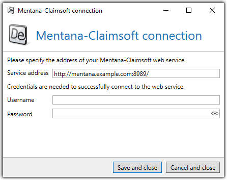

- Enter the service address at which the web service can be reached.
Enter the credentials to access the service.
- Click Save and close.
NOTE: The information entered in this dialog is immediately available for both the De-Mail send connector and the receive connector. This means that you only have to configure the connection once and it is immediately available in all connectors.
