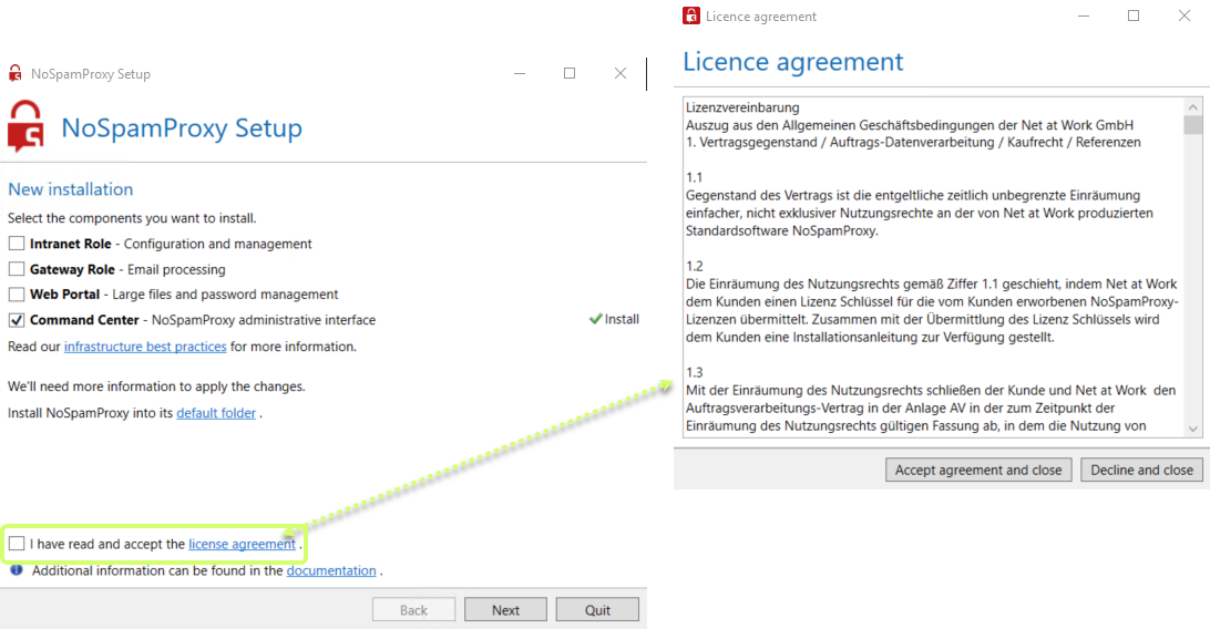

Starting the installation
- Click the setup file of NoSpamProxy. The wizard guides you through the installation.
The following contents are relevant during installation:

Installation types
The setup differs depending on whether you want to perform a new installation, a change or an upgrade:
Installation type | Definition | Properties of the setup |
New installation | NoSpamProxy is currently not installed. | During installation, you have the option of selecting individual components for installation. You also need to set up the database, the database server and the installation folder. |
Changing the installation | A NoSpamProxy installation in the same version as that of the setup is currently installed. | During installation, you have the option to keep, install or remove individual components. You can also adjust the settings for the database, the database server and the installation folder. |
Update | A NoSpamProxy installation in a lower version than that of the setup is currently installed. | You update your NoSpamProxy installation. The existing settings are adopted. |
